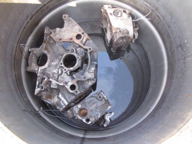

Tecnically, this isn't a tool, but since I changed the water in my "engine vat" today I thought I would take some pictures and share them.

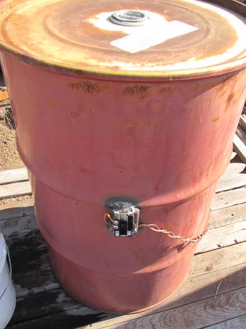

Here she is, a 55 gallon drum with a lid.

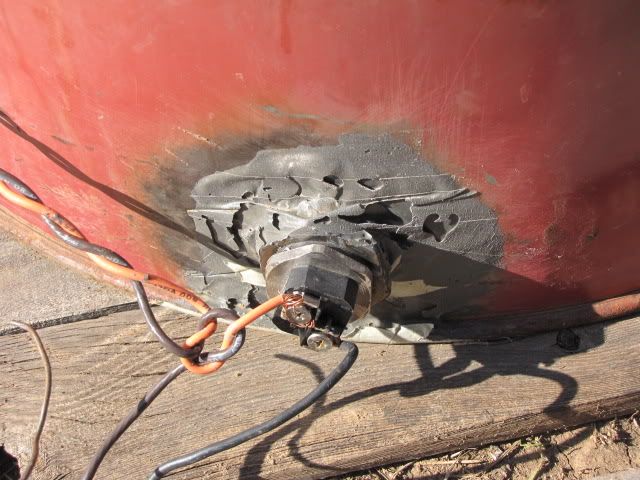

On the front is a thermostat for an electric hot water heater.
On the back, at the bottom, is a heating element for an electric hot water heater. It is a 110 volt, 2000 watt element. It's the highest wattage 110v one I coud find. It take a while to heat the barrel up from cold but it will doi it (about 8 hours). You can get elements in 220 volts up to 5500 watts, you can also wire up dual elements.

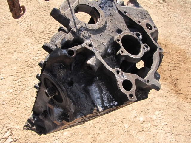

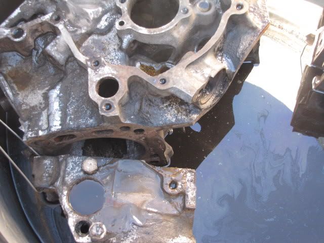

Here is an engine that has just finished its bath. I have bailed out several gallons of water to expose the engine.

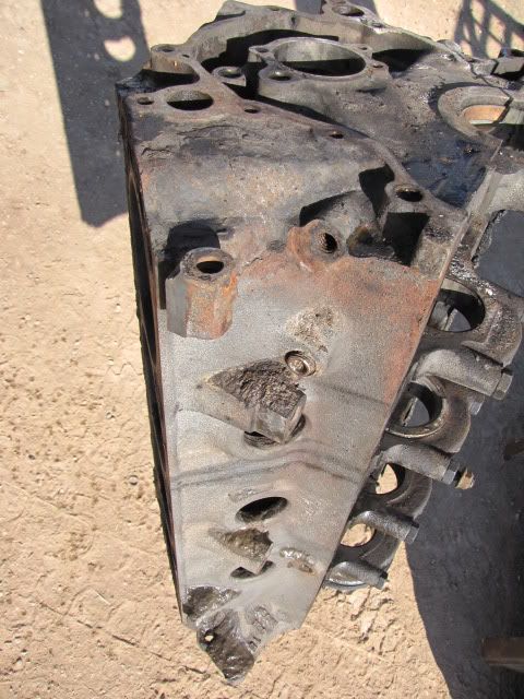

It's a 1980 Ford 302, and it was nASSty. I didn't take any "before" pictures though.

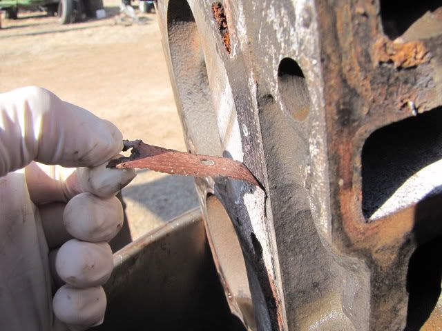

Stubborn (head gasket) material that would take endless scraping peels right off. If it won't peel off then one swipe from a razor blde take it clean off.

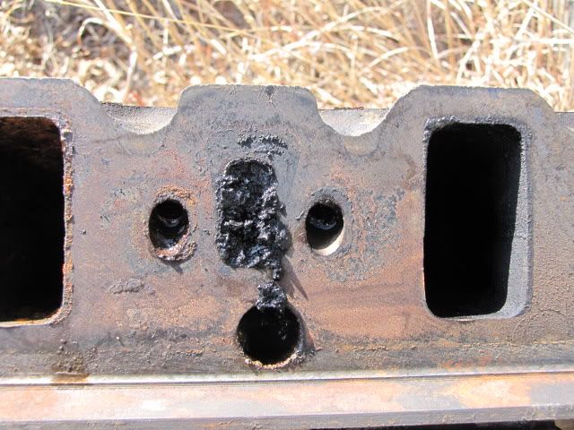

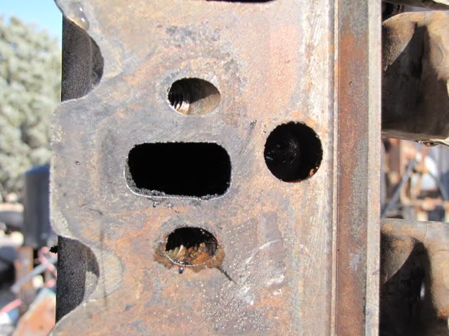

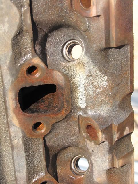

The carbon in EGR passages can be hard as concrete, but many times after a bath the carbon breaks apart like sand.
This carbon was a little tougher, but a few seconds with a screwdriver and this passage is clean.

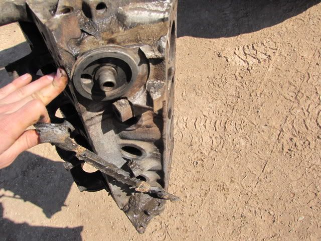

Notice how the oil pan gasket came off in one strip.
The block and head casting was really grainy and rough.

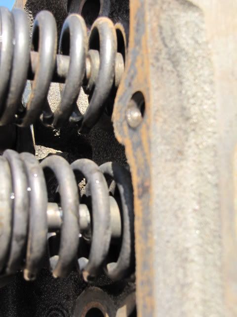

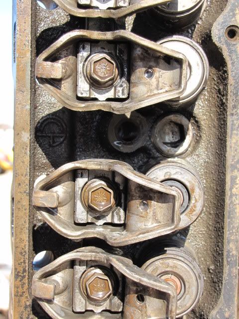

WTF?!! No valve stem seals! Maybe they disolved or broke away inside the engine.

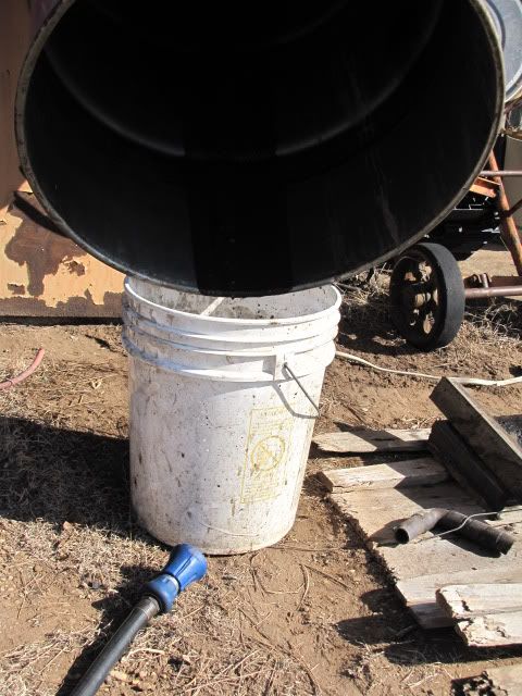

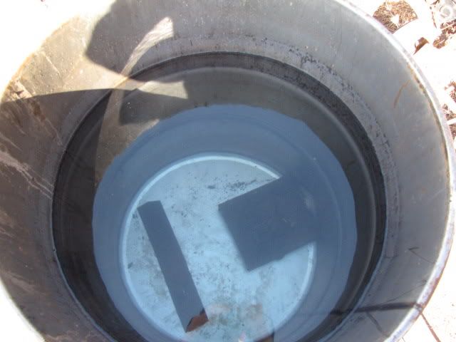

After I have bailed out all the dirty water, I tip the barren upside down over a bucket and spray out the sludge.

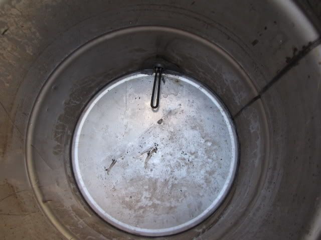

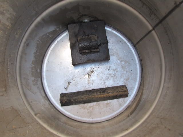

Heres the element.
I place a piece of channel iron over it to keep it from getting damaged. There is a piece of angle iron in there too so blocks will sit level across the bottom. And it leaves a gap so water can circulate under the engine too.
I fill it 3/4 full, thats enough to cover most any engine.

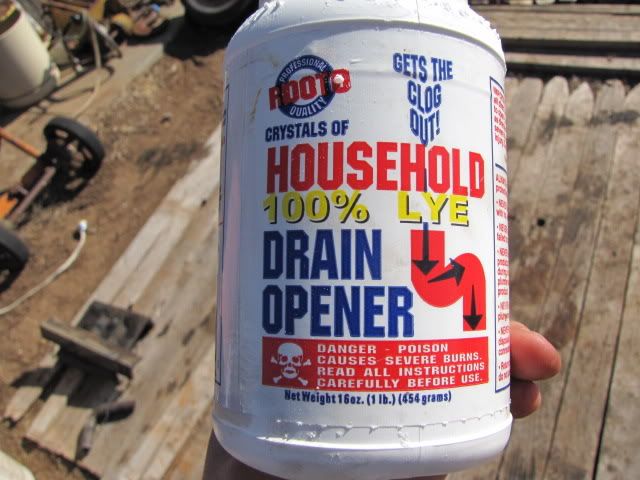

This is the stuff that makes it all melt away.
The engine that I showed may not look clean but the pictures don't do it justice. The block casting was VERY rough, almost like 40 grit sand paper. It was striped to the bare metal.

I start fresh with 3# (thats 3 bottles) in the barrel, if after a couple of engines I notice a decrease in cleaning power I will add another bottle. Anything past 5# you might as well change the water, clean the vat, and start fresh.
Some quick FYI,
#1-Tide (the laundry detergent) has Lye in it. It can also be used, I have done it myself, but I don't recommend it. The problem with Tide is that it also has OTHER chemicals/fragrance/stuff in it, and you have to use a LOT to get the same cleaning power as straight Lye. Tide is about 9% Lye, and there is so mush perfume in it the steam will gag you.
#2-Lye is also called "sodium hydroxide" or "potash", it is a powder or chrystal.
#3-You used to be able to buy Lye in 50# and 8# containers at most hardware stores. Plumbers called it "sanitary lye", and used it to sanitize the area wherever sewage spills occured.
Now the 1# bottles are about all you can find, most hardware stores and some grocery stores have it. It's with all the other drain cleaners.
The only way to buy it in large quantites now is from a chemical supply house.
#4-DO NOT use liquid drain cleaner, that stuff is totally different. DO NOT use Drain-Out crystals, or simmilar products. They contain other chemicals and aluminum. MAKE SURE what you use is 100% LYE.
#5-Lye is used in the production of "Meth", no I don't know how. In some communities Lye is regulated and you have to show ID and signature for it. I suspect this is one reason why you can't find it in bulk anymore.
#6-Lye is used to make hominy, that corn dish we love to hate. (I hated hominy as a kid, now it's not so bad)
#7-Lye is "alkaline" or "base", which is opposite of acid on the Ph scale. It can be neutralized with vinegar (which is acidic).
#8-Lye is hygroscopic (it will absorb moisture from the air and disolve), so it MUST be stored in a sealed container.
